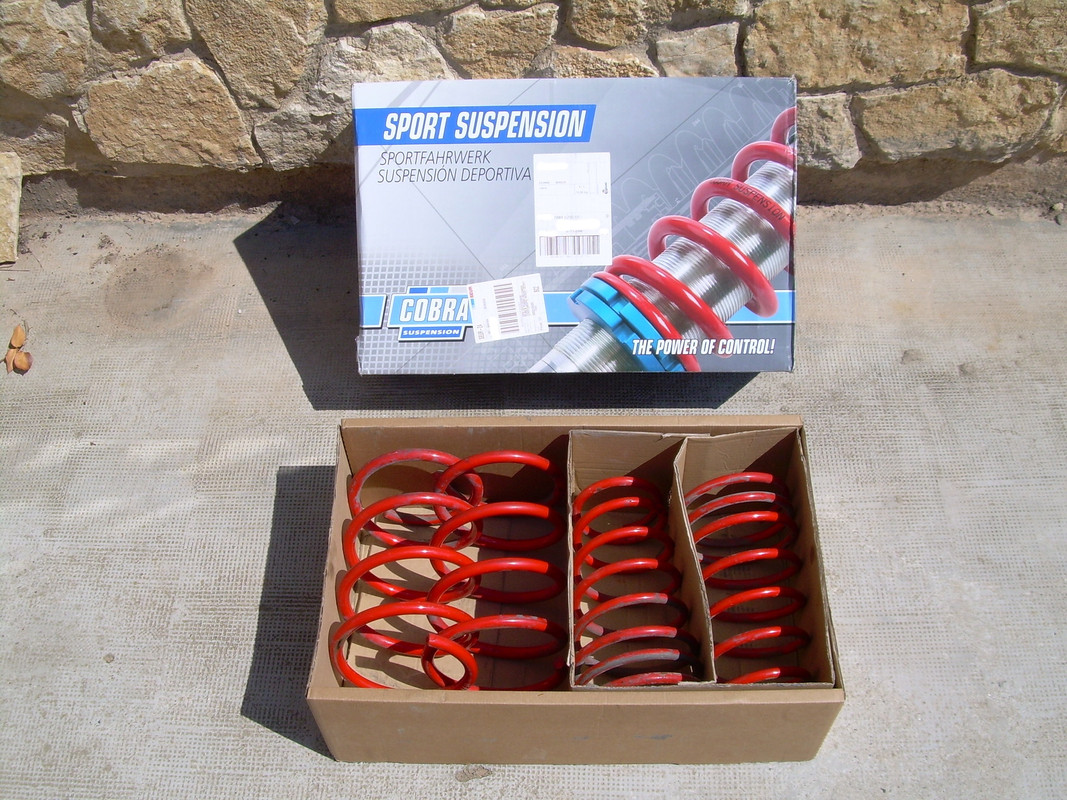

Please, I would to know your opinion about what are the brand of the most smooth and comfortable low springs for the Cougar.
In other words, I look for low springs with the most similar smooth and comfort of the original spec springs. ( I know that low springs implies always a harder suspension).
In the past, I have installed in my Cougar a COBRA low springs (-40 mm, part number 2874, specific model for the 2.5 Cougar) with original specs Monroe shock absorvers, and the result is that the suspension car became extreme hard, every time I passed over a pothole in the road the car seemed to break in two.
-I only look for aestethic (low car), the better performance of the srpings is secondary in this particular case.-
My car is a 1998 Ford Cougar 2.5.
So, what are, in yor opinion, the brand of the most smooth and comfortable low springs for the Cougar?
Any help would be appreciated.
Thanks in advance and sorry for my bad English.

You will want to look for a PROGRESSIVE spring. Those will have the coils spaced further apart on part of the spring, and closer together on the rest. The wide coil gaps handle more gentle changes in suspension, while the tighter coils only come into play on harsh changes.
LINEAR springs (have the same coil gaps top to bottom) will always have a harsher ride. Those Cobra springs appear to have a progressive rear spring and a linear front.
