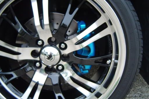

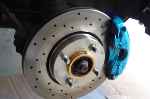

I recently ordered new KVR Cross-Drilled front rotors and Mintex A/F Street Pads from Sp Motorsports. I went to put them on and noticed a broken wheel stud(@!#$). After replacing the stud I was able to change out the pads and rotors and while I was at it I went ahead and painted the calipers.

Ok thats is nice but you HAVE to remove the speed clips. When putting on custom wheels you must remove these. Custom wheels do not have a recess for them like stock wheels. Meaning your wheels dont sit flush on the hub.

I did not realize that and you are the first one to tell me but I will sure remove them. Do you think they might be causing me the little virbration that i am getting?

Clips are gone and it rides alot smoother now thanks.

and a hubcentric ring also helps
67 Posts
Discussion Starter · #11 ·
The goldish copper ring on there is a hub centric ring.
