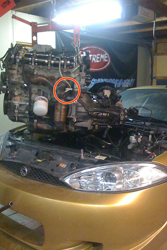

    I re-tested and passed nearly everything with FLYING colors. The only fail I had was the HC ppm under dyno load. The limit is 60 and I got 74. Everything else was WAY under the limit. He recommended I change the other upstream O2 sensor as they are usually done in pairs so the computer doesn't miscalculate a wrong balance because one is stronger than the other. Past that, I've done EVERYTHING else recommended by people and I'm now scratching my head.
    Does anyone know where I can find the other upstream O2 sensor? I did the one at the top under the coilpack. Where's the other?!?

    on the front precat

    OK.. I found it... thanks.

    The front manifold has two in it; it's the upper one; it's above the oil filter. Best reached from underneath.

    Here ya go:

    OK. I changed that O2 sensor. Does anyone have ANY other suggestions of something I could fix / change / do to help with my hydro-carbon emmisions?????? I'm retesting at 11:00am tomorrow morning so now's my chance to get it right. I don't know what else I can do if it's a fail again tomorrow. Cougarfest will become a fading dream if that happens.
